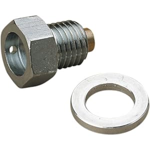

    These magnetic drain plugs for the DR have proven their worth:
    Photo #10656
    Yermo
    11 years ago
    DR650 NSU spring
    DR650 NSU spring
    To our dismay, the Neutral Sending Unit screws, plunger, and spring had fallen out on Duncan's DR650. We pulled the side covers off and used a void scope best we could to inspect the engine for damage and any sign of the missing pieces. Several attempts yielded nothing. Duncan suggested maybe screwing in the powerful magnetic drain plug he had gotten. Upon screwing it in I heard a click and pulled it back out. This is what we found.
