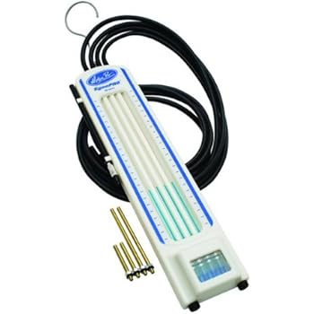

    To sync the carbs we used one of these:
    Link #54474
    Yermo
    8 years ago
    Amazon.com: Motion Pro 08-0411 Syncpro Carburetor Tuner: Automotive
    Buy Motion Pro 08-0411 Syncpro Carburetor Tuner: Motorcycle & Powersports - Amazon.com FREE DELIVERY possible on eligible purchases
    https://www.amazon.com/Motion-Pro-0...
    (affiliate link)
    It's been a while. I no longer remember exactly how we went about setting the mixture. There's a black art to running the bike and checking the plugs to determine if it's lean or rich. There are a bunch of youtube videos on it.
    I seem to remember at one point when we had the carb sync way out of adjustment that we also got dead spots. So I would definitely check the sync. If the bike has been sitting for any length of time, I'd suggest cleaning the carburetors if doing plugs, valve adjustment, and sync don't fix the issue. We ended up pulling the carb rail so many times that we got to the point we could pull the rail and reinstall it in under I think 15 minutes.

     as far as that sync Pro thing that's pretty much exactly what I was going to build I watch the how to on YouTube that somebody built one and compared it to an actual manufactured one and had approximately the same result but it might be just worth buying a Quality Tool it usually is in my experience.
     now I have a general idea what I'm looking for is that the vacuum throughout Idol mid-range and wide-open should pull approximately the same vacuum if not exact but how exactly am I to go about syncing carburetors I don't really want to have to send it to a shop because I don't have the money for it and if I can't do it myself it bothers the crap out of me but I also don't want to get into a mess that's over my head as far as reading plugs white bad tan good black rich but yeah if anybody could give me a quick rundown on what I'm looking for in a carb sync that would be cool or maybe just a link.
     and what would I do to create a small vacuum leak remove a carburetor from the intake plenum slightly or pull one of the vacuum Port plugs off somehow like how much of a vacuum leak in my looking to create the kind of simulate the problem in a worse way to diagnose it.?

    With a sync you're not looking at absolute numbers but relative. As you open the throttle you want all four carbs to pull the same vacuum so they are in balance. You end up hooking up your 4 port vacuum gauge to the vacuum ports and then adjusting the screws on the carb rail until they are more even. Ben probably remembers better than I do, but there's also a step involved of zeroing out your gauge before you use it so you get accurate numbers.
    It's a tuning process so as you change one the others will get affected. As I mentioned, there are youtube videos and the process is described in the Haynes manual. It's been too long since I've done it so the details are a bit fuzzy for me at the moment.

    As far a syncing carbs goes, I would recommend using a tool like the one Yermo linked to. They're inexpensive enough, and you want a tool that you can trust to be accurate. The gold standard seems to be a Tecmate TS-72, but they are prohibitively expensive. When I was going through the process, I considered building one of these DIY digital sync tools. http://www.venturerider.org/forum/showthread.php?73158-Built-a-digital-carb-sync
    The process is pretty straight forward. You're going to calibrate the tool so that the levels are all the same when they're plugged into one carb body, then connect the tubes across all the bodies and see if the levels are still the same at various RPMs.
    You'll need to have the tank off because the way you adjust the balance is by turning the screws between the carb bodies. There are three screws, one between the left pair that adjusts 1 & 2 relative to each other, one between the right pair that adjusts 3 & 4 relative to each other, and one in the center that adjusts the left pair relative to the right pair. You want to start by adjusting each pair separately, then adjust the center to bring the left and right into sync. It will likely take a few iterations (and some patience) to get everything synced up nicely. It doesn't hurt to periodically re-calibrate the tool (sanity-check), especially if the what the tool is telling you doesn't match with what you're hearing from the engine. As it gets more in sync it should sound more smooth, more even.
    As you get it into tune, try adjusting the idle speed screw (underneath the carb rail, between 2 & 3) to the lowest RPM where it still sounds smooth. Should be close to 1200 RPM I think. And I like to adjust the throttle using the throttle cable adjuster, it allows you to make small incremental changes and know that it's being held steady while you're taking a reading on the sync tool.
    The easy way to create a vacuum leak is to pull the cap off of a vacuum port on one of the carb bodies. You can do that while the bike is running and instantly hear the difference, then plug it with your finger to control the size of the leak.

     I do think I'll go ahead and just buy a sink gauge instead of doing the DIY one because the price of the materials versus the price of the tool and then making sure that they're accurate makes sense to just get the right tool I never even thought to look to see how much a sink tool was I just figured they're really expensive.
